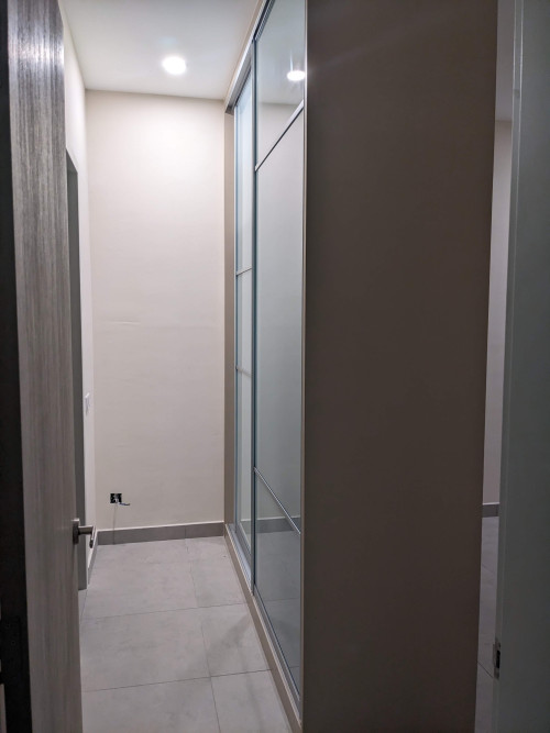

i'm moving to an apartment for the 1st time in my life. we have done built in cabinets from floor to ceiling there. i asked the cabinet contractor what is the weight limit for each shelf. he didnt know. he just said best to keep heavy stuff low and light stuff up. anyone know what the safe weight limits are on these kind of cabinets.

QUOTE(kesvani @ Nov 11 2023, 10:17 AM) Hai ya. Do your own calculation. See what the material used for cabinet and the support it use. Customise stuff can calculate but proffesional fees lor. Contractor job pasang only. how to calculate? i even check ikea website, their tall wardrobe that look similar to what i have, material also similar. but they dont have any weight related info in their safety or measurement section |

Light materials ok. Max 50kg. Reason because some wardrobe used pegs to support the shelves. My IKEA wardrobe Max also 50kg. If need to add heavier items, I will add L brackets on all 4 corners. roadie liked this post

QUOTE(acbc @ Nov 11 2023, 10:49 AM) Light materials ok. Max 50kg. thanks! i just got thru to ikea customer support. they said for tall wardrobe, 35kg per shelf, recommended max 5 shelves per tall frame, and 25kg on top of the frameReason because some wardrobe used pegs to support the shelves. My IKEA wardrobe Max also 50kg. If need to add heavier items, I will add L brackets on all 4 corners. acbc liked this post

It depends on the design of the wardrobe and how it is secured to the wall Some of these factors include the width of the shelf, the materials of the shelf and carcass Wood don't break out of sudden, if you try to place heavy item in it you will see it start to sag or start making cracking sound, that's when you know you need to stop roadie liked this post
