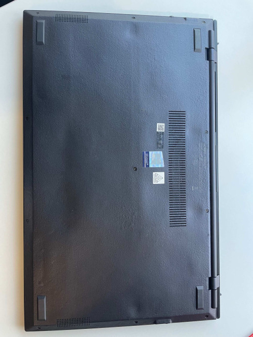

Has anyone who own ExpertBook B9 model came across the bottom cover somehow dented and forms bubble after sometime?
Mine is 3 years plus and sort for realize recently that the bottom is uneven and formed bubble. Wonder if it was due to the heat? rclxub.gif

hmm, could it be the battery bloated?

QUOTE(kuntilanak @ Oct 27 2023, 09:07 AM)
I thought it as first too but the dent is not only at where the battery is, it's the entire bottom cover surface. cry.gif

well, i think the only way to find out is open it up and see...

QUOTE(kuntilanak @ Oct 27 2023, 09:36 AM)

anything unusual under the hood?

QUOTE(kuntilanak @ Oct 27 2023, 02:29 PM)
Nothing at all, very strange to see the bottom cover become dented for no reason. doh.gif

hmm, if no weird things going on, then maybe not a concern...
still, how's the system / CPU / GPU temperature when running?

plastic part for electronic commonly use PC/ABS and the melting point is above 200c,
deform caused by heat from the system is unlikely, unless the device was put constantly under heat stress aka from direct sun light, sun light can degrade plastic.
another possibility is the bottom already deformed since bought due to molding cosmetic defect.

QUOTE(kuntilanak @ Oct 27 2023, 04:25 PM)
Nothing concerning, all running normal.
QUOTE(1024kbps @ Oct 28 2023, 12:47 AM)

My old asus laptop had this issue as well. Forgot which model was it but I guess it was heat that caused the bubbles and deformed bends. Wasn't really bothered about it coz it didn't really affect anything like performance issues or overheating. Worth a try to contact Asus service centers if you are concerned.

I believe this is eligible for warranty claims. Give it a try.
Tried calling them but I was only noticed it 1 week after warranty ends! So basically they told me I need to pay for the inspection and replacement of the cover cry.gif
QUOTE(Liuteva @ Nov 2 2023, 10:12 AM)
I was about to but was only realize the bump a week after the warranty ends. So Asus told me I need to pay for it. cry.gif

Sent to Asus Authorized Service Center and get the bottom case replaced. Now it's good as new, cost me RM 259 as it's out of warranty.
I notice that CPU/GPU temp is sometime shoot up to 70 degrees and it's damn hot at fan area cry.gif
