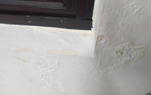

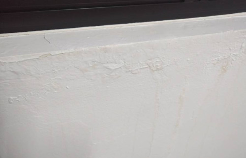

Suspect my windows or area surrounding is leaking. During rain, water seems to flow out from under the paint/cracks surrounding the window. Pretty severe during heavy rain, actually can form a pool on the floor on some occasions.
Contractor has not surveyed site but has suggested PU injection. Quoted over RM 1k. Area is just 3 aluminium windows in single frame. Is that rate normal? Any other recommendations? Is DIY possible or advisable in this instance? ![]() ![]() |

QUOTE(tryagain @ Oct 18 2023, 10:48 PM) Suspect my windows or area surrounding is leaking. During rain, water seems to flow out from under the paint/cracks surrounding the window. Pretty severe during heavy rain, actually can form a pool on the floor on some occasions. Condo or terrace ?Contractor has not surveyed site but has suggested PU injection. Quoted over RM 1k. Area is just 3 aluminium windows in single frame. Is that rate normal? Any other recommendations? Is DIY possible or advisable in this instance? ![]() ![]() Possible to take some photos on the outside window ? ... Near and far shot each. This post has been edited by mini orchard: Oct 18 2023, 11:10 PM |

QUOTE(mini orchard @ Oct 18 2023, 11:09 PM) Apartment, not able to take outside photo atm, update later.QUOTE(lankorn @ Oct 19 2023, 12:43 AM) Nope, normal open/close window.Main query atm, is the rate of RM 1k + for PU injection for just these 3 connected windows normal? |

QUOTE(tryagain @ Oct 19 2023, 10:26 AM) Apartment, not able to take outside photo atm, update later. As for my window, silicone solved the leaking problem. Nope, normal open/close window. Main query atm, is the rate of RM 1k + for PU injection for just these 3 connected windows normal? As for pu, it cost me rm500 6 years ago for a leaking wall. BTW mine is a landed property. |

Big area window? Is ur hand able to reach the outside face of the window lowest part?
If can then DIY n test first, get some clear silicone glue, apply it on the whole stretch of the window, where ever u feel water can seep in. Apply few times, sacrifies ur finger n press the glue into every mini tiny hole/gap u feel there is. Mine same situation, heavy rain, water flow from the crack paint. After I DIY, so far 3 years no issue (touchwood) |
