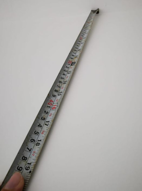

My house ceiling height is 9 ft and plan to do plaster ceiling 3-4 inch lower. I have measured from original ceiling height to my raised up finger, the gap is about 19 inch. After minus plaster ceiling 4 inch, the left over is 15 inch. Is there any recommended low ceiling fan model from panasonic or KDK? Please advise.

QUOTE(Thrust @ Sep 14 2023, 03:50 PM) 9 feet is rather low... even most condo standard height is 10 feet.. Nope. It's a new house. Just got the key few months ago. If not, what can you recommend me to do? Don't do plaster ceiling or only do L-box at the side?Is that an old house you plan to renovate? This post has been edited by goolie: Sep 14 2023, 02:52 PM |
