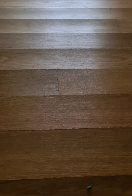

You should use the wet vacuum machine and expose the affected area to sunlight. I experienced a similar leak three months ago, and the apartment's cleaner helped me suck up the water, preventing damages to my laminate furniture. Unfortunately, the water and moisture did cause floor warping later. So, consider myself lucky since I only need to spend 1k plus to sanding the floor.

Mine is timber floor and moisture was trapped under the wood. You may want to contact your SPC installer to see if he could dismantle and dry your SPC to prevent moisture trapped below. For my other furniture, since I dried them within hours, they are okay. I only suffered minimum damages. You need to suck out the moisture and water asap.
