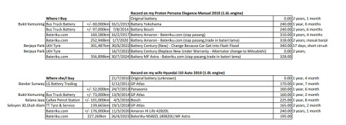

QUOTE(ARMI85 @ Sep 28 2024, 08:54 AM)
I keep detail record of battery that my car (Persona Elegence Manual 2010) and my wife car (Hyundai i10 2010) use all this year.....
Currently me and my wife using Astra battery....
Well done. 👍👍👍
I presume that you have used the same battery sizes and spec throughout the period, that is Persona DIN65L or DIN55L or NS60LS ?
If you don't mind, for the Hyundai i10 what battery size did you use ?

QUOTE(ARMI85 @ Sep 29 2024, 08:18 AM)
How to know what DIN number from this picture ? there is 40 number there can we said it was DIN 40 ? ... hmm.gif
For RFB Regular Flooded Batteries, there are generally classified into 2 categories NS for lower capacity batteries and DIN for higher capacity batteries and they are generally mutually exclusive. NS batteries are generally taller compared to DIN batteries too.
NS40
NS60
NS70
NX120
DIN44
DIN55L
DIN66
DIN75
... until
DIN100
Currently there are no DIN40 batteries at the moment but it's hard to say, what the future will be. As modern vehicles demand more and more power from the batteries due to extra electronics etc, car manufacturers may demand battery companies to produce batteries that meets their demand. Example if you think that the NS40ZL battery is the smallest, Honda battery is even more comel, length shorter by 1cm compared to other OEM batteries for that size. So cute. Product differentiation.
