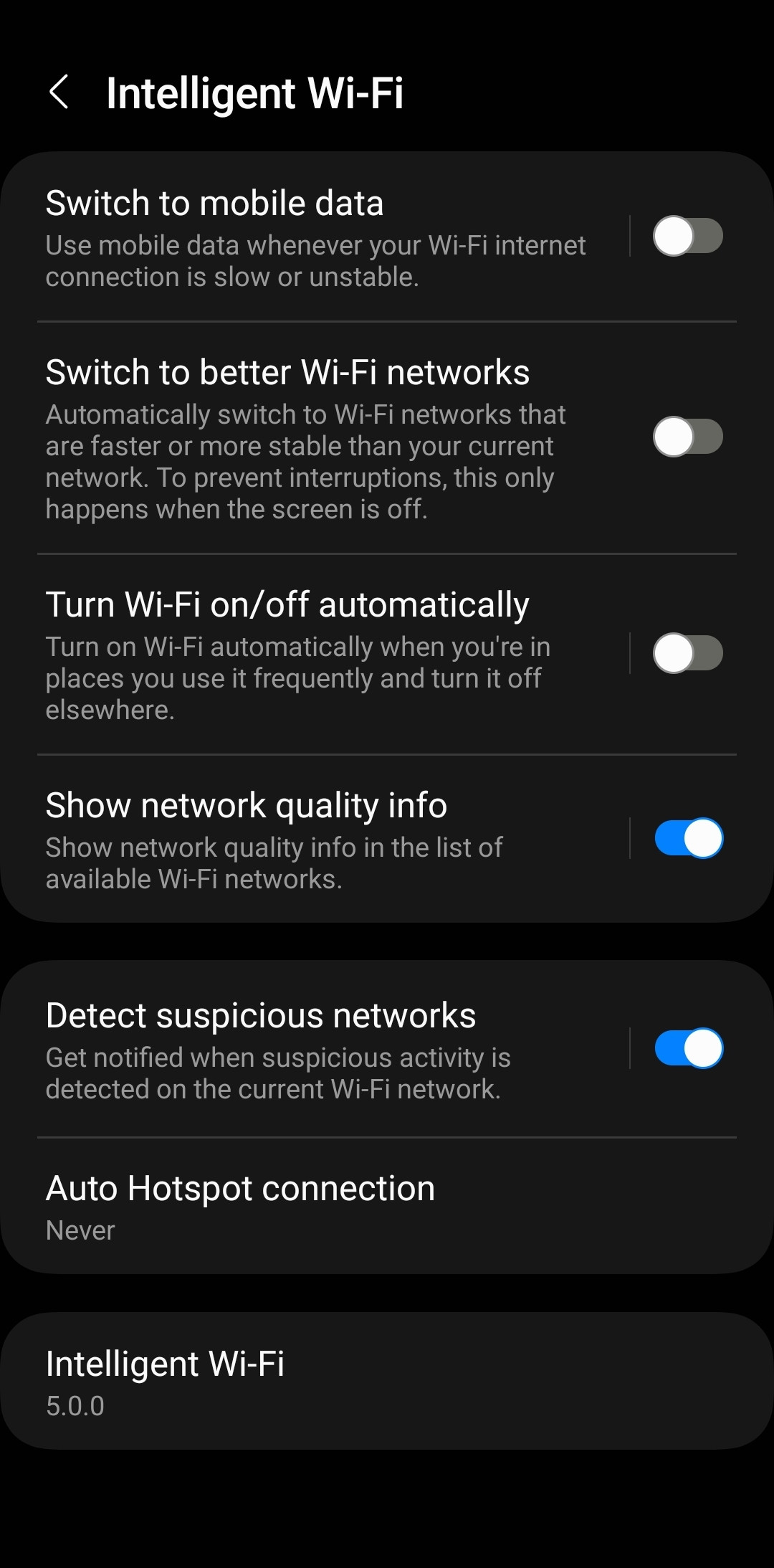

u might want to try setting on phone too…but this is for off-screen la.
