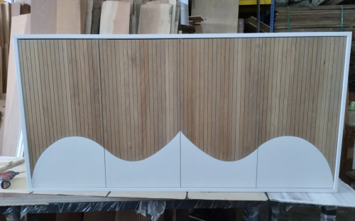

yesterday installed this sideboard.
4 door fully solid wood sideboard.
solid wood door are made with fluted real white oak panels.
tuning the doors didnt take too long.. 15-20min to get them inline. decent oem type good quality hinge.
This post has been edited by ar188: Sep 17 2023, 09:36 PM
