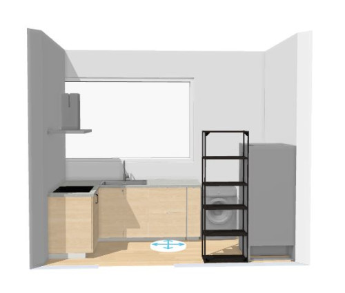

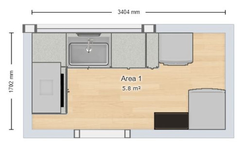

Hi,
I just wanted to ask opinion and advise on the kitchen layout which I have designed using IKEA planner.
My kitchen layout would typically look like the drawings below, with the actual dimensions of the fridge, washing machine and kitchen hood/hob as per my purchase. I also most probably will add few more elements i.e. wall shelves, wider storage shelves (beside the fridge)
In term of measurements and distance between the different elements, is it ok or practical for my kitchen area?
I am open for any suggestion and improvements.
Thank you.
NOTE:[B]
1. Ceiling height = 3124 mm
2. Hood height from kitchen counter = 750 mm
3. Kitchen cabinet will be done by kc contractor, so the height and depth will be designed according my preference. In the drawing, kc is based on the IKEA Planner. I (i.e. 80x60x80 cm and 60x60x80 cm).
heater8812
post Aug 19 2023, 06:01 PM
37 posts
Joined: Dec 2021
Would rather have smaller sink or shortened the counter instead, so can fit in the fridge next to the washing machine.
amduser
post Aug 20 2023, 05:19 PM
5,542 posts
Joined: Dec 2006
I would go for 90cm counter top height, and cooker countertop tension at 80cm, if your height is over 170cm then 90cm is more comfortable
And your sink is too near to the cooker, if you use water while cooker is cooking then water will splash to the cooking area

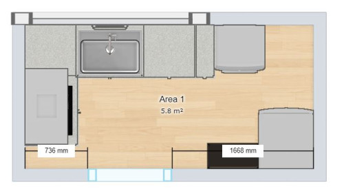

I have changed the layout a bit.
Thanks for the pointers. Moved the sink farther to the right and shortened the right counter of the sink a bit. Also changed the placement of washer and fridge

QUOTE(Bijisss @ Aug 21 2023, 01:41 AM)
With this layout you don't have enough space for preparing ingredients, where are you going to chop vege and meat
Or you can move sink to farthest right, then you have a space between cooktop and sink for that purpose
And you need to see where is your water supply inlet and drain for the sink, if you move the sink too far from the drain you will need to drill your cabinet for the extended pipe and might affect your drawer space if there is any
Also make sure your washing machine door can be fully open and doesn't hit the fridge or cabinet in front of it, and of course you need to have enough space to stand in front of the washer to take out and put in laundry, do look at the measurement also instead of the design alone
