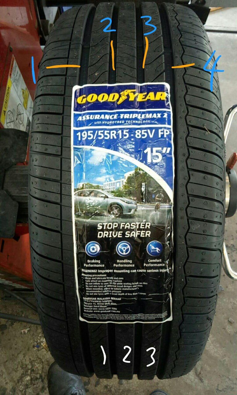

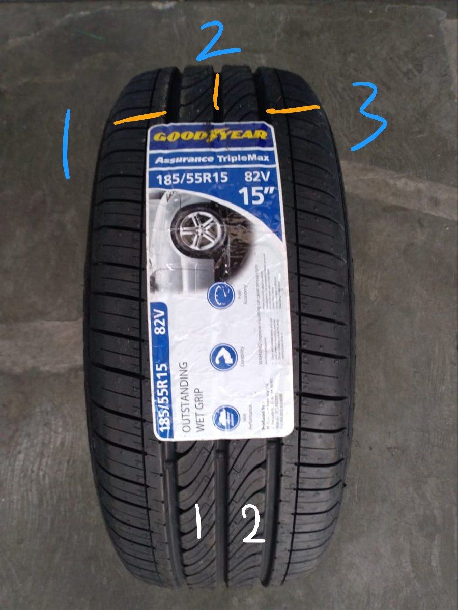

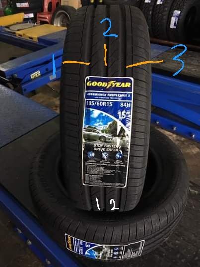

some rims looks good on 185 but not 195
not sure the rim width of persona, but for saga ori 185 using 195 is not nice.
taking goodyear atm/atm2 as example, 185 and 195 got a bit difference in thread design.
atm 185/55/15
atm2 185/60/15
atm2 195/55/15
This post has been edited by BOTAK_WAI: Aug 20 2023, 02:04 AM

QUOTE(BOTAK_WAI @ Aug 19 2023, 11:30 PM)
atm 185/55/15
atm2 185/60/15
atm2 195/55/15

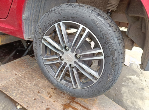

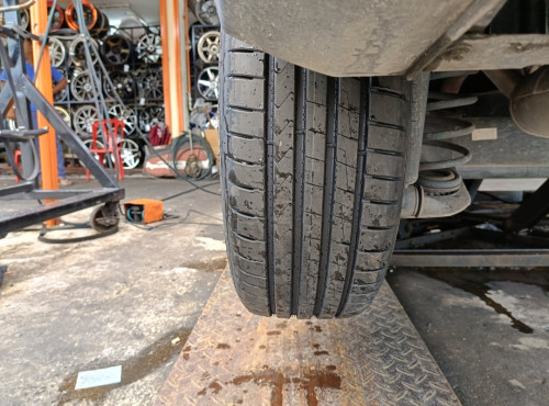

Thanks for showing the 195 and 185 tyre different, yes the 195 width having 4 longkang. The tyre shop starting only talk what model they have for 185, when i say wanna change 195 he directly bring me inside the shop and start introducing all the model he have. Lol.....
Just got my tyre change to hankook ventus prime4 195/55r15, put it on rear and front still the existing 185/55r15.
