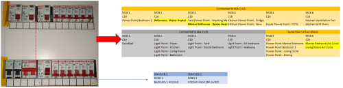

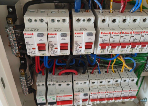

I requested for RCBO for my water heater, but this is the outcome, I'm trying to understand from the contractor but he say very complicated,explain also I don't know
What I see from here I FEEL it is very weird, the My kitchen hood and one of the aircond is connected to RCBO and 25A ELCB instead of water heater.
When I turn off or trip off the 25A ELCB with test button ,the power running for kitchen hood and one aircond , only turn off when I press test button on the RBCO or turn off the main switch. What actually went wrong?
*Typo, one is 63A , another is 40A ELCB, connected with RCBO one both is 25A

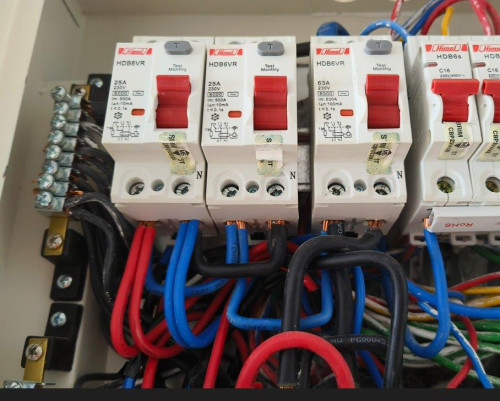

The 2 Himel 10ma RCCBs seems to be wired incorrectly and serve no purpose. It could be done so on purpose to bypass the RCCB by the contractor because there are shared neutrals between the circuits and they are too lazy to fix it. I doubt they are that retarded to so by mistake.

So they contractor not only bluff me about RCBO but also make my 10mA rccb become dummy? My water heater is now just connecting directly with MCB?

Wiring also blue color got neutral and life 🤦🏻‍♂️🤦🏻‍♂️🤦🏻‍♂️, correct way is mcb out to rcbo 10ma than rcbo to water heater

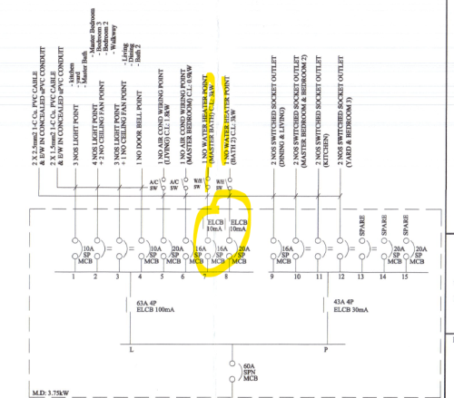

this is the original one before the contractor me to add more point and rcbo. originally 2 water heater are connecting to 2 separate elcb and mcb, can this prove that it is using differen neutral ?

If the original circuit has working RCCB + MCB for both waterheaters, it will also mean there is no shared neutral. There is absolutely no reason for it to be bypassed or wired incorrectly unless they mess up the original water heater circuit afterward. It could be as stupid as new ventilation fan neutral from the water heater and live from lighting or vice versa. Rather than guessing, it's better you ask the contractor to rectify it. If they really add more points looped from waterheater circuits just to save cost, fxxk 99 them.

This wiring is correct (.....well except for the 2.5 mm² wires used. Should be 4 mm²) with each Water Heater protected by an MCB (in case of shorting) and an RCCB (10 mA sensitivity, in case of current leakage)
Why did you install the additional RCBOs?

Your contractor has rewired it wrong. If you can, just replace the two 10 mA Himel RCCB with the Schneider RCBOs. All wiring the same as original and you should be good for the water heaters.
Both the Himel RCCBs have 2 in and 2 out wire connectors, as does the Schneider RCBOs. Swap 1-to-1, same hole to same hole - as per the original developer wiring

From the developer diagram, the MCB+ELCB (10mA) (i think is RCCB) is already following Suruhanjaya Tenaga guidelines and provided protection for overload + leakage current.
Use RCBO if only MCB is provided, then people replace the MCB with RCBO to provide 2in1 protection where there is no RCCB connected.

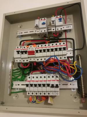

RCBO/RCD must have two cables on top and on bottom so it can operate. Yours is 1000% dummy and serves no purpose. Refer my pic the top right, far right RCD (the big block).
The RCD on the left not connected, that time didn’t install second WH yet, no moneh
In any case it should be double protection as in one mains 63A 30mA output (Load) to the 10mA input (Line), not line to line connection. The idiot who installed this don’t know what he/she is doing. Pls get a proper wireman certified with PW1/PW3 certification to make it good.
The WH RCBO/RCD supposed to be sub/final circuit not the main circuit (main power outlet). In this case shutting off the main RCD and MCB does not cut power to entire house since WH circuits are still hot. Pls bear in mind this is very dangerous ⚠️
