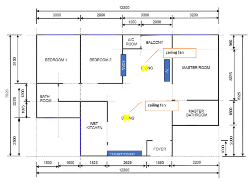

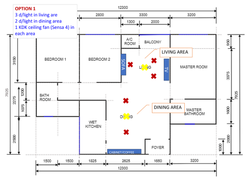

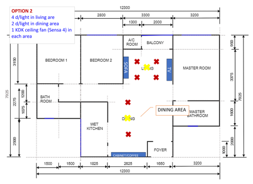

Hi sirs,
I am planning to install PHILIPS Meson LED Surface Downlight in my living & dining area. From y
I have 2 options as attached diagram (option syok sendiri haha), from your opinion which Option is the best in term of brightness of the area?
I am totally open for any suggestion and advise..

A lot of light for just 2 M apart also, too near tv. 1 center?

You were saying that the options I have are too much of lights, is it? Then how many of light is sufficient with the size of living and dining area. I wont install plaster ceiling, so I will use surface downlights (from OSRAM or Philips).
I really has zero knowledge about all this, the plan of lighting layout was simply my syok sendiri. sweat.gif Please help me...

Owh you mean to install 1 light in the centre. Is it 1 light of Philips Meson LED Surface Downlight or OSRAM LEDVANCE sufficient to cover the whole living area? and from my little research, lights also have different size/watt? so which size/watt is most suitable if I use 1 light?
How about dining area, also install 1 light?

ok let say i use 1 light, i cant install it at the centre as a ceiling fan will be installed. so which side would be better. on sofa or tv side?
I would suggest put 4 corners.downlight. e27 so you can play with remote control eg yee light
Strip lights indirect shining up on the wall, separate circuit
The light should not shine on people eye when sit down on sofa

THANKS SO MUCH!! I think ceiling mounted downlight with E27 at the 4 corners is a brilliant idea for my case.
I will just buy casing for the bulb. I might consider strip lights as well, from google pictures it looks so fancy and giving me atas vibes..
