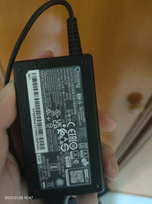

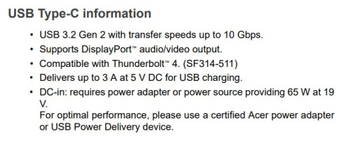

I'm using Acer Swift 3 , these details
i'm using this adapter

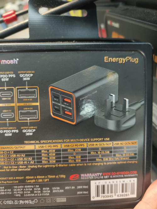

I'm plan to buy this GAN Charger

seems like not enough juice, and voltage not same also

Based on the original charger, you need a Gan charger capable of minimum 65W on the USB-C1 port

Looks like your laptop wants a 65W USB-PD Charger
the charger you posted would work, BUT, 65W is only if you dont use the other ports, would recommend getting a 100W one so that you have 35W left over to charge your other devices such as your phone
