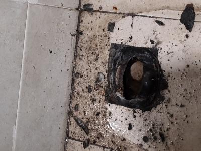

In my case, the original contractor didn't place the rubber properly when placing the toilet bowl.
Was OK at first, then toilet bowl kept getting clogged later on. Not sure why it deteriorated.
Had to hack and remove the toilet bowl and fix it back.
