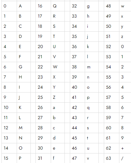

This is the encoding table, from 0 to 63:

After grouping, it is easy to refer 24 = Y, 22 = W, 9 = J, and 35 = j. (the index starts from 0)
