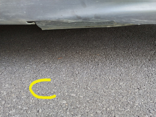

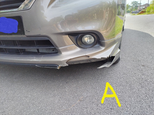

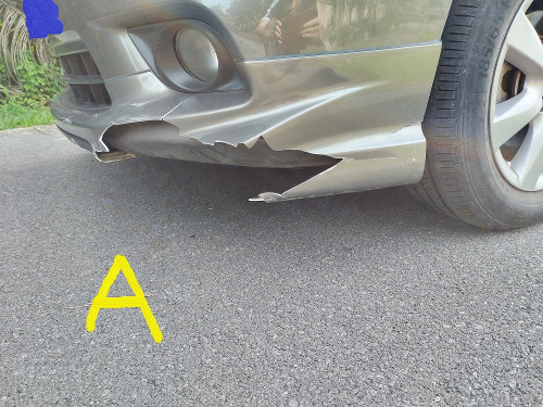

A - is the right side of the front skirt. Totally pecah.

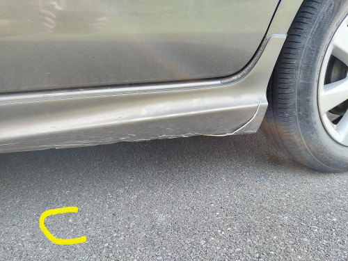

C - is the side skirt (right side). If I look from the floor, also pecah a lot.

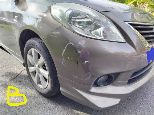

B - is near the driver side. This one not the skirt but rather the main body I think. This one scratched by some box truck. So I'm thinking if the shop I'm sending can fix that paint even better la. But if cannot is fine. This one not very urgent.
Thank you in advance.

A. Need to buy new front skirt, roughly around rm250-300 maybe before painting. The painting cost could be around 150.
B. Need to repaint the bumper, maybe around rm150-200.
C. Similar like A.
You need to send to body repair/paint shop but I suggest you look online to buy yourself first so the body shop only need to paint and install, otherwise they will charge much more expensive for the skirting.

What he mean is just taking off all those skirting cuz those are just accessories glued/double taped on top of the original body. So behind those skirting you'd find the actual car body which should still be in nice condition but just need to clean up from the gum residue. So that way you won't need to spend much on anything.
Aircon/battery/tyre shops won't do such repairs. If you worry about buying wrongly online then find a body kit accessories shop, usually they sell such skirting often including painting and installation too so should be practical for you.
