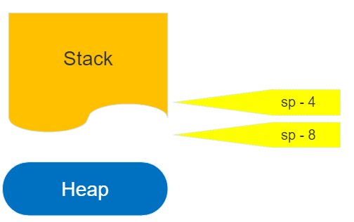

A picture tells the thousand words:
In x86 systems, stack is growing to the bottom (shrinking to the top), while heap is in opposite direction.
But today I will just focus on stack. What is stack?
QUOTE
Stack is just a memory with pointer.
When we add parameters onto stack, the stack pointer decrements. We call it "push" operation.
But when we "pop" it off the stack, the stack pointer increments.
Stack is LIFO, also known as "last in first out"

As a bonus, I will show how to do an alternative of "push" operation.
CODE
sub esp, 4
mov dword [esp], val1
Now it reserves stack space of 4 bytes first, then store the "val1" parameter onto it.
Sometimes a program may reserves stack space of 32 bytes (multiple of 16) by doing like this:
CODE
sub esp, 32
Then it can do whatever it wants with the allocated stack.
To point to any of the 8 parameters ( 32/ 4 bytes = 8), it can then use ebp (points to the value of esp before allocating 32-byte stack space), or by referencing to esp directly:
CODE
mov  eax, dword [esp + 28]
This will copy first parameter pushed to stack (remember stack grows downward) to eax register.

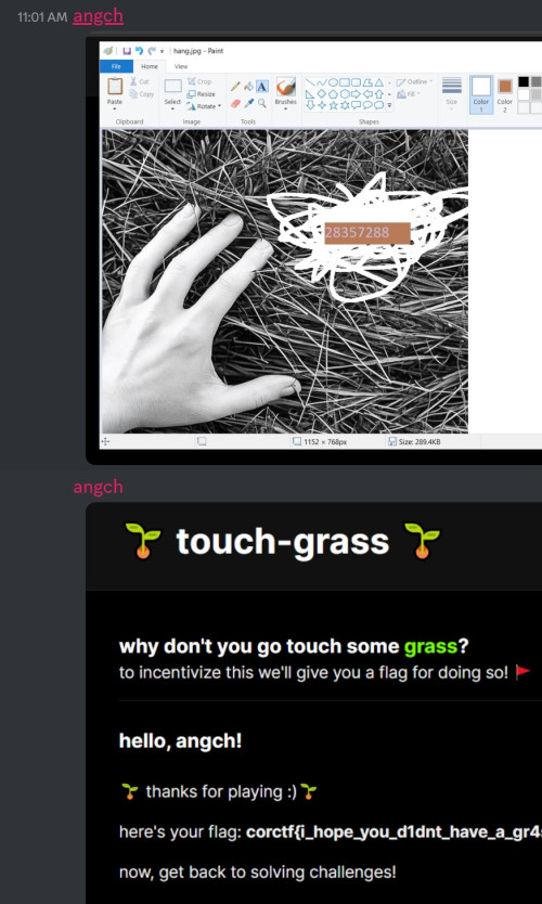

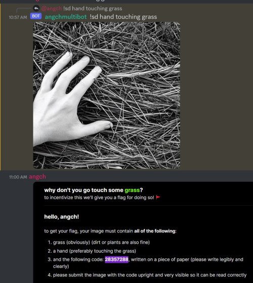

TSMatQuasar
post Jul 30 2023, 06:02 PM
Validating
329 posts
Joined: Jun 2023
QUOTE(angch @ Jul 30 2023, 12:52 PM)
Ez.
(ok, the rest is harder)
Nice, you can make use of your discord bot!
QUOTE
misc/touch-grass
Strellic, FizzBuzz101, 0x5a
65 solves / 147 points
Vitamin D deficiency and complications from a sedentary lifestyle are plaguing the CTF community.
To help change this, the esteemed CoR tribunal has decided that touching grass in sunlight is a vital part of this CTF experience.
Trying to trick this system will result in your team being placed on a hall of SHAME - the entire world will know that you don't touch grass!
touch-grass.be.ax
