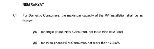

Conditions for NEM, SelCo programmes relaxed
Still kena limit to 5kW for single phase. Macam kena con by menteri
Attached File(s)
Attached File  For_Solar_Photovoltaic_Installation_Under_The_Programme_Of_NEM_Rakyat_And_NEM_GoMEn_In_Peninsular_Malaysia.pdf ( 7.1mb ) Number of downloads: 116
