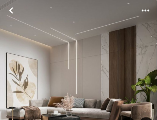

nastasha1103
post Jan 18 2024, 01:29 PM
3 posts
Joined: Nov 2021
QUOTE(amduser @ Jun 30 2023, 11:46 AM)
if you want to save money then dont do plaster ceiling and you get higher ceiling height too, replacing surface light with the same type of light is easy, just plug and play replacement, but for installation you will need more powerful drill since ceiling is usually reinforced concrete
the problem without plaster ceiling is to hide all the additional wiring for those downlights, and you wont get those fancy accent lightning that you see from plaster ceiling too
actually both type of light that you mentioned is also called downlight
surface downlight = install without plaster ceiling
recessed downlight = install flush with plaster ceiling, most of the internal is hidden inside plaster ceiling
you can go for LED track light or magnetic LED track light, you can conceal wiring at the side of the track and magnetic track light has many type of lights that can easily replaced surface downlight
surface downlight can be use at smaller area for example at living room to room walkway, entrance foyer, balcony, toilet, yard, and maybe kitchen
hi, for this design, possible to not do plaster ceiling and just do LED track light?
amduser
post Jan 18 2024, 07:25 PM
5,542 posts
Joined: Dec 2006
QUOTE(nastasha1103 @ Jan 18 2024, 01:29 PM)
if you want to do exactly in the picture, you will need plaster ceiling and wall panel, concrete wall can do it but it is a lot of work to hack the wall, and if you stay in condo, it is usually load bearing wall and not allowed to hack
if you dont want to do plaster ceiling you can only go surface light design, cannot look flushed like what you see in the picture

rogeRRabit
post Jan 22 2024, 02:55 PM
56 posts
Joined: Sep 2020
Keen on installing this type of lighting too
But wouldn't it be a hassle to replace the LED strip?
As I know it needs a power driver and this is easy to replace.
But the LED strip is embedded in a tunnel,
need to pull out the whole strip?
ChuanHong
post Jan 22 2024, 03:50 PM
I <3 Xperia
4,412 posts
Joined: Jan 2013
QUOTE(rogeRRabit @ Jan 22 2024, 02:55 PM)
in normal case, tend to use aluminium casing to put LED strip.. yes, driver is required.. can be hide inside plaster ceiling at nearby downlight for future replacement on driver..
need to calculate the length of LED strip that u required on each.. wiring works need to done at earlier phase of renovation before plaster ceiling works..
