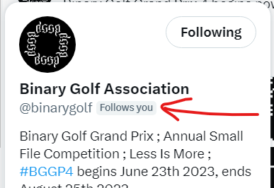

Good news for me! It is definitely an honour to be followed by the organizer of BGGP (Binary Golf Association)!
I am one of the 37 users whom they are following on Twitter.

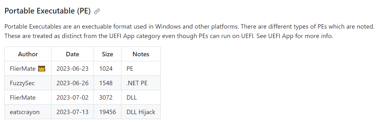

Someone almost beat me with its small EXE! Fortunately I still win after comparing the final size:
His/Her: 1548 bytes .NET PE
Mine: 1024 bytes PE (standalone)
You can read up about his/her write-up here:
https :// knifecoat.com/Posts/Writing+Small+.NET+PE's

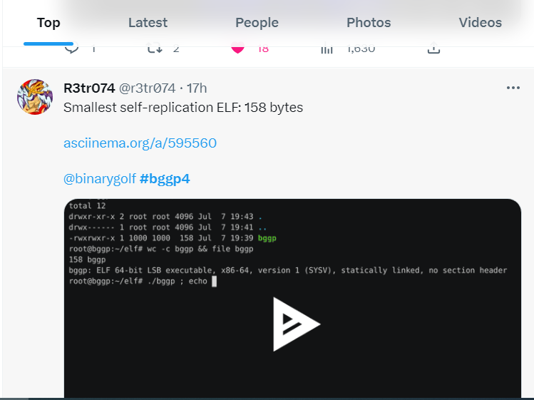

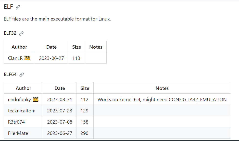

I submitted another Linux program, 290 bytes for self-replicating file, using syscall 0 (sys_read), 1 (sys_write), 2 (sys_open), 3 (sys_close), 60 (sys_exit) and 85 (sys_creat for creating file).
I don't think conventional programming can do smallest program, but anyhow I have participated with two entries, 1KB PE and 290-byte ELF64.

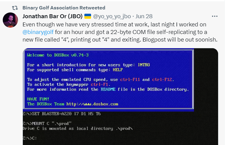

Someone posted a DOS COM solution at just 22 bytes! Terrific!
And when you think it is not possible to further squeeze it, someone came up with 18-byte DOS COM code snippet!
https :// github.com/yo-yo-yo-jbo/binary_golf_com/issues
They used very sophisticated technique that if I joined one, my DOS COM would be 50~60 bytes, I think.

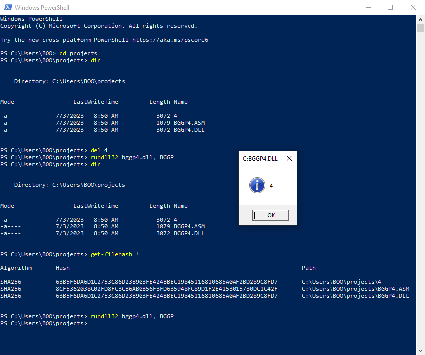

I sent another entry, this time is DLL.....

Whoa! A security researcher beat me with his/her 158-byte ELF! I surrender! hmm.gif
His recorded video : https :// asciinema.org/a/595560
