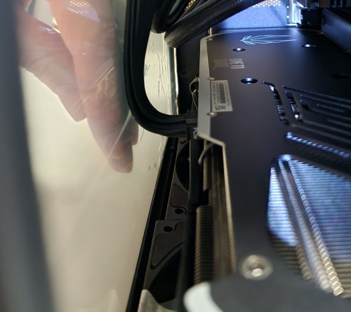

Anyine using a Tecware VXM case with Zotac RTX 4070 Ti here?
I have this combo and the gap between the gpu and tg side panel is too close.Been finding ways to connect the power cable to the gpu and close the side panel without bending too close the 12vhpwr cable.
Need some help here, building for the first time.

Either go vertical gpu mount or remove TG or get Cablemod 90 degree or 180 degree adaptor. Best to ask cable mod on which one to get.

90degress cablemod is the best way. Moving forward.
Unless mau get a bigger case.

i'm thinking of getting this https://shopee.sg/EZDIY-FAB-12VHPWR-12-4pin...215.22038893180
its from taiwan. Not sure how the quality will be, plus they stated the adapter supports up to 450W, not sure its ok for now and future.
Currently the 12VHPWR is connect thru 2x8pin to the PSU. PSU will be Corsair RM750e (ATX3)
