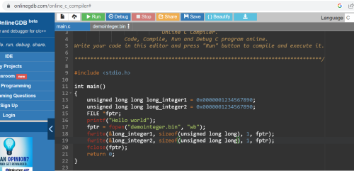

#include <stdio.h>
int main()
   unsigned long long long_integer1 = 0x0000001234567890;
   unsigned long long long_integer2 = 0x0000001234567890;
   FILE *fptr;
   printf("Hello world");
   fptr = fopen("demointeger.bin", "wb");
   fwrite(&long_integer1, sizeof(unsigned long long), 1, fptr);
   fwrite(&long_integer2, sizeof(unsigned long long), 1, fptr);
   fclose(fptr);
   return 0;
Output

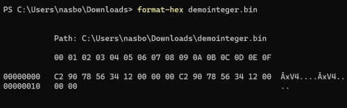

CODE
C2 90 78 56 34 12 00 00 00 C2 90 78 56 34 12 00
00 00
Hope it helps.
KLKS
post Jun 14 2023, 06:04 PM
292 posts
an unsigned long long is 8 bytes, where did the 0xC2 come from?

QUOTE(KLKS @ Jun 14 2023, 06:04 PM)
This is the result from @tboxmy code :
demointeger.bin (16 bytes)
90 78 56 34 12 00 00 00 90 78 56 34 12 00 00 00
Don't know why (and how) to get the different result.

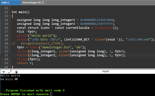

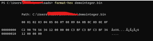

1. I dont have a PC with C compilers anymore...sigh! The online Compiler in use is https://www.onlinegdb.com/online_c_compiler# where I suspect it compiles to UTF.
2. When compile with LANG or LC_ALL default on Linux would be LANG=C. However, where LANG=en_US.UTF-8 then the hex values will differ as what I have shown. LC_TYPE value is connected too, need to check if you plan to use utf8 (which is widely used on global wide applications).
3. If you execute/run this a.out or binary, it should display the unicode as shown in attachment.
4. The unicode should display as shown by E2 98 A0, where you can refer at https://www.utf8-chartable.de/unicode-utf8-...rt=9728&names=-
CODE
#include <limits.h>
#include <locale.h>
#include <stdio.h>
int main()
  unsigned long long long_integer2 = 0x0000001234FFFFFF;
  const struct lconv * const currentlocale = localeconv();
  FILE *fptr;
  printf("\n%d bits \%s\n", (int)(CHAR_BIT * sizeof(void *)), "\xE2\x98\xA0");
//   str=getlocale(LC_CTYPE);
  fclose(fptr);
  return 0;
Lots of this is just off my mind. Do read up for actual reasons.

Using the online hex viewer, https://www.scadacore.com/tools/programming...-hex-converter/
Attached is the output, and how that would have shown 0x0000001234567890 in its utf-8 instead of ansi ascii.
Hope that helps.

after read carefully, is the format-hex add additional characters.
The first line should be the "original hex" and follow by formatted hex / text.
The demointeger.bin should be 16 bytes.
This online hex viewer show the file content :
HexEd.it - Browser-based Online and Offline Hex Editing
https://hexed.it/
