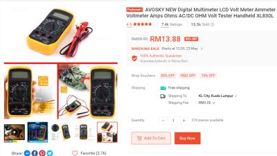

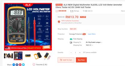

Hi,
Planning to get a multimeter for simple home DIY stuff.
So many on the market. Which are the better/accurate/reliable one to get.
Going by the number of buys on Shopee, are the following worth getting?
BelaCHAN
post May 22 2023, 10:31 PM
579 posts
Joined: Jun 2007
From: Subang Jaya, KL
Between these 3, Uni-T is ok.
Personally i'd stick with kyouritsu haha.
hr_elie
post May 22 2023, 10:40 PM
237 posts
Joined: Nov 2005
From: Ipoh & Cheras
Uni-T is better from the other 2.
Some more got NCV function so can detect power line in the wall.
This post has been edited by hr_elie: May 22 2023, 10:41 PM
SUSceo684
post May 22 2023, 10:42 PM
Component Burner
11,667 posts
From: Klang/Subang
cheap one is cost cutting design, if anything goes wrong, it has no safety feature - will blow up in a manner that can and will hurt. This blow up usually happen when wrong mode is selected.
if you just use for AA battery or 9V battery test any meter will work, however don't use elcheapo meter for AC (mains) work.
IMPORTANT- if you are touching 230V u need at least a CAT III 300V rated meter.
Else Uni-T UT201 to 204 (some new version old version- diff by red clamp black clamp- u research urself lah) clamp meter.
1. Cat III 300V rated
2. Clamp meter for contactless AMPS measurement. See #5
3. Auto-ranging make life easier
4. True RMS measures modded waves better (inverter output).
5. Note: NOT all clamp meter can measure capacitance.
6. NCV light, test pen light, all need Live-Dead-Live and best to just shutdown power when working on 230V.
This post has been edited by ceo684: May 22 2023, 10:47 PM
alepfx
post May 22 2023, 10:43 PM
34 posts
Joined: Mar 2011
Uni-T or Sanwa or Pro'skit or got budget go for fluke.
