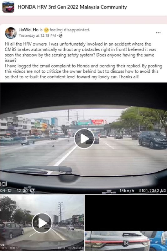

From honda SC technician mentioned if CMBS activated with auto brakes applied, we need to brakes to cater the sensing thereafter it will give back the control to you
CMBS auto turn on every time after restarting car
Cancel CMBS by fully depressing the accelerator pedal

This HRV old version no ADAS

sunlight problem

Luckily Geely Proton use radar based. Camera based sensor get this weakness. Inb4 made in Alor Gajah sure many cut cost

phantom braking.. ciplak punya honda CMBS sensor..
cant differentiate bridge shadow and car.

Problem when relying 100% camera. Unlike x50 using radar + camera.
Now i sked i kena this with my FE but dont want to turn off in case real car suddenly brake in front.

myvi ASA also 100% camera what.. ok only never heard of such problem on myvi before..
and with the volume of myvi's being sold out there easily double or triple the amount of honda's with such systems as well..

sensitivity
that guy honda might set to highest or high
my benz sometime also will random prompt when there are sudden environment change (like from sunny day go into underground parking) or like this kind of bridge shadow
it will auto open all sensor , rear view camera and start beep beep beep
not sure how benz front collision work..sometime it will auto disable entire parktronic system for like 5 to 10min (maybe mismatch result in between camera vs radar kot)

sensitivity
Even with the highest sensitivity set, it should not brake as per video

ya.it shouldnt
until Honda fix this issue ..best is dont set to highest ..atleast minimize the chance of random trigger
maybe japan or thai their road "contrast" didnt different that much (assuming they only use camera)

Those camera based sensor is shit only radar is more reliable. The moment Tesla shift from radar to vision, it's auto drive system has gone shit. Even their own engineer spoke up against it.

this only happen to lower end ADAS system. Use camera instead of radar.
camera based similar like our eyes, from bright space to dark, camera is blided, tot got wall or something, then hard brake.

QUOTE(cfa28 @ May 15 2023, 12:48 PM)
just disabled it lah
QUOTE(MegaCanonF @ May 15 2023, 01:01 PM)
Tu lah these days kereta manyak elektronik i takut liao
I wouldn't buy top spec cars for this reason. Avoid cars with lots of sensors.
This post has been edited by Skylinestar: May 15 2023, 02:36 PM

QUOTE(JoeK @ May 15 2023, 02:28 PM)
lazy to go down to snap ; at 0:22 ..u can choose on Active Brake Assist or something
then u can adjust the sensitivity to standard or sensitive
this is old w213 ..newer UI i remember got different naming like LOW/MID/HIGH
play around when i get the car ..after that just save according to profile ..when my dad drive ..he use his own profile
Honda should have something like this kot ..i didnt owned honda car so i dunno

perodua ASA use 2 cameras while Honda Sensing here use single camera iinm
2 cameras can calculate depth, single camera 100% purely on AI calculation

Apparently it is the sudden dark triggers it, the camera suddenly sense how it becomes so dark and get scared then break forcefully, Honda needs to train the car to not scare of the dark

sounds like cross is less likely to encounter phantom braking? Cross adopts radar + cam for its pre-collision system.
"Pre-collision System is Toyota’s speak for Autonomous Emergency Braking (AEB). It utilizes a camera as well as a millimeter-wave radar to detect possible collisions and slow the car down to avoid or reduce the impact.
With Pedestrian Detection, the system is able to determine possible collision with crossing pedestrians as well as cyclists, and automatically apply the brakes if the driver does not brake in set time"

damn, when ADAS screw you over.
i personally don't like all these fancy features; yes it is a safety perk for the driver but sometimes when it doesn't work properly, you get screwed over.
Ashroft98
post May 17 2023, 11:07 PM
228 posts
Joined: Jul 2013
So often lalu this road with my HRV. No issues so far even with similar shadows on the flyover.
Does driver use ACC during the incident?
