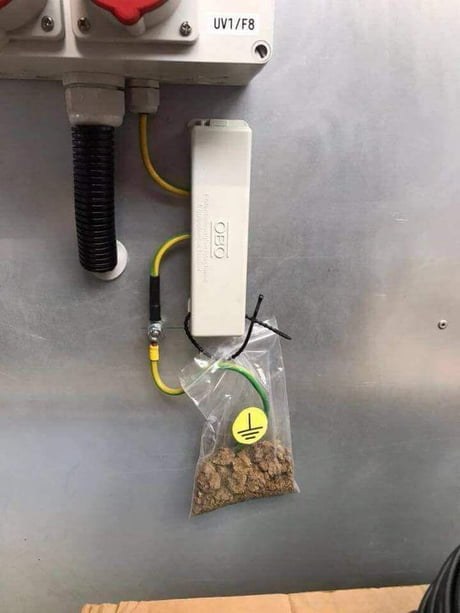

DDG_Ross

QUOTE(DDG_Ross @ May 11 2023, 07:26 PM)
Funny, how working like this
ayamAnoob
post May 11 2023, 07:29 PM
140 posts
Joined: Mar 2021
DarkAeon
post May 11 2023, 07:42 PM
774 posts
Joined: Nov 2010
like that better setup altar at data center, pray pray everyday everything works
smart, i wonder why ppl wanna pull long cables.
