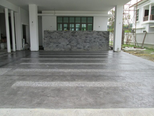

I have a big muddle puddle car porch, I want to turn it into cement because everytime after raining my car tyres all mud. But I don't have much budget/cash to do it. Can anyone advise me what is the most economy way to do up my muddy car porch? Just cement it without putting tiles cheaper right? How about concrete imprint method (like the one in photo)?

Can just put a layer of gravel?

might need to put rebar to reinforce the concrete, if not it might crack after some time
maybe you can put red clay brick also

Ya need rebar.
red clay brick cheaper than cement?

The price you need to ask your contractor or seller which method is cheaper
If you just want to diy or temporary solution then brick is less messy and easier
The best permanent solution is rebar with concrete

concrete imprint will be quite expensive also.
maybe a layer of crusher run?
