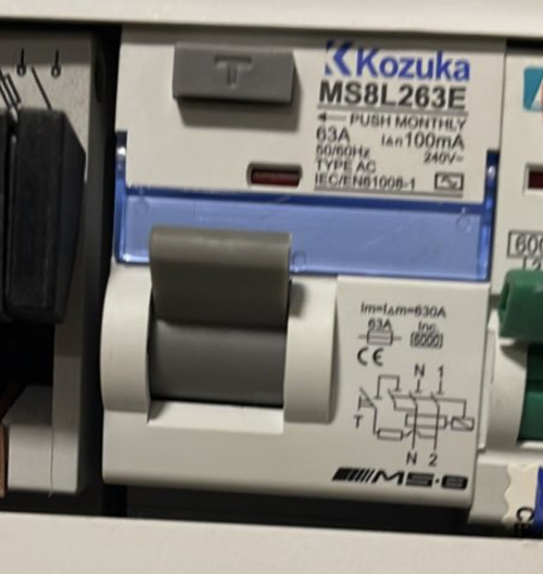

Your RCD pic? Got cheap ones w/o anti nuisance trip and that’s probably why u kena so many nuisance trips
Kozuka brand. Previously no such issue though. Just happening lately. I just bought a maxguard one to try and swap and see if it solves the problem
