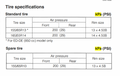

Old cars like Kelisa didn't need so high pressure
https://eownersmanual.perodua.com.my/assets...mkelisa2001.pdf

QUOTE(dylan_chng @ Apr 20 2023, 07:15 PM)
Nothing to do with old or new, its to do with your tyre size and sidewall size

This. Simple thing to follow from car manual also cannot no wonder mechanics boom in Malaysia.
matmoto5125
post Apr 21 2023, 06:28 AM
Silent Reader
1,305 posts
Joined: Sep 2007
See at door frame la. Follow that if u still using ori tire size.
