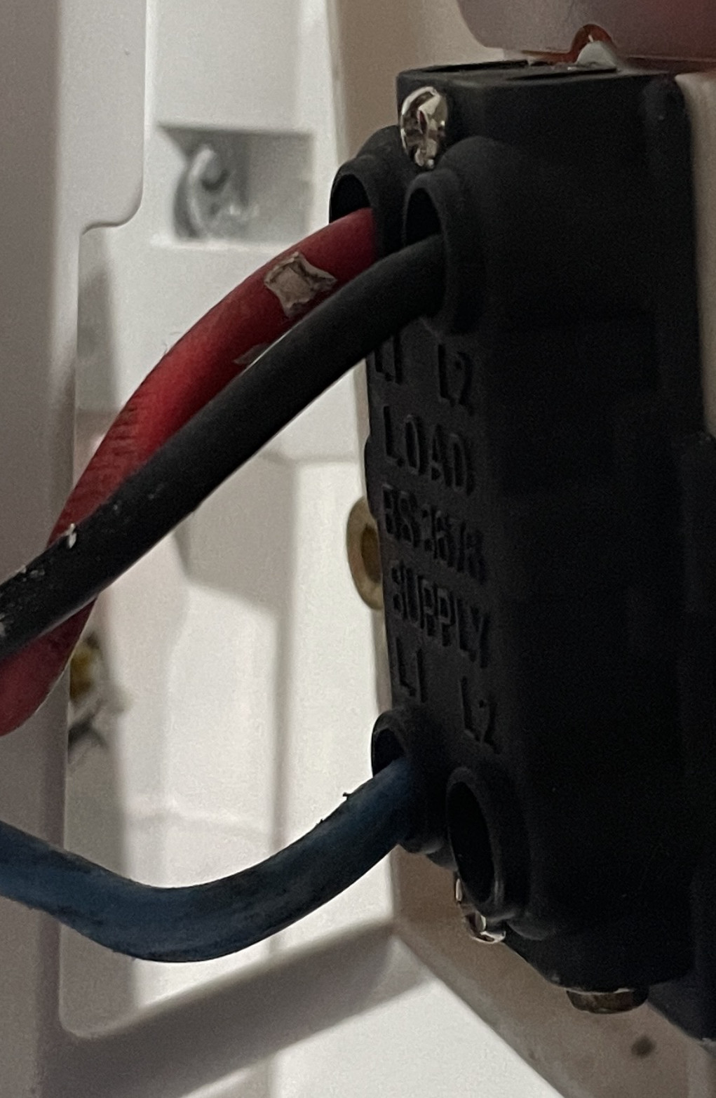

Hi guys, I’m wondering how come my aircond switch has only one neutral out but missing of neutral in.
Can I still take a loop from neutral out to my smart switch? » Click to show Spoiler - click again to hide... « |

Most probably tapped the neutral direct from another socket or wiring point.. lol. tsk.. ezpz job like that.. dangerous though.

QUOTE(PowerGadget @ Apr 13 2023, 12:57 AM) Hi wondering whether those regulator ceiling fan can be connected to Aqara h1 light switch as on off switch? I tried to connect it but it seemed like disable the whole switch. When I remove the fan, it seemed fine. I dont think so if the switch requires a Neutral wire. All switches are only live wires.. You need to pull down a Neutral wire to use that switch.. PowerGadget liked this post

QUOTE(bobowyc @ Apr 13 2023, 01:06 AM) I dont think so if the switch requires a Neutral wire. All switches are only live wires.. You need to pull down a Neutral wire to use that switch.. I tapped from my aircond switch to my smart switch. It works when I only connect it to my lamps. But once I connect L2 to my regulator kdk fan, it stopped working. Any ideas why it acted like that? |
