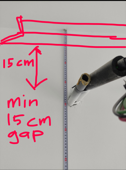

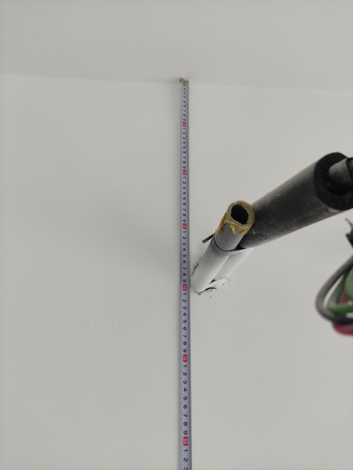

QUOTE(Created On 21/1/2021 @ Apr 7 2023, 06:18 PM)
Note: Photo above is before plaster ceiling.
My plaster ceiling drop will be 10cm.
Once the plaster ceiling is installed, do I still have enough space to install my air cond?
My air cond dimension:
Indoor (H x W x D) (mm) 288 x 770 x 234
I am trying to avoid doing a pelmet design for my air cond.
Hai looking at your site condition , you do not have sufficient space … bare in mind that from ceiling you need a gap of minimum 15cm … some even suggest optimum of 1ft gap for proper airflow …..you need this as it suck air on top and blows cold air inside your room …
Cheers mate

Many thanks.
It looks like I have no choice but to do plaster ceiling pelmet for my A/C.
