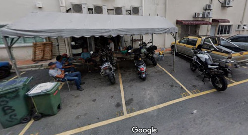

QUOTE(harryleesbr @ Apr 7 2023, 02:35 PM)
Thanks. May I please check with you whether you know of recommended workshops in KL/PJ that specialize in this model?
you mean independent workshop?
https://goo.gl/maps/SGUdtKHv3mtusSAR6
En. Ahmad the boss: Go to the back alley, its next to Hodaka Motorsport PJ
