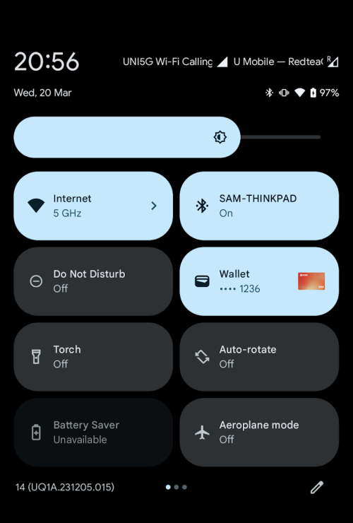

Sam Leong
post Mar 20 2024, 08:59 PM
665 posts
Joined: Mar 2016
QUOTE(poh880 @ Mar 20 2024, 10:00 AM)
What phone support Unifi Mobile VoWiFi?
I use Google Pixel 6, can use unifi mobile VoWiFi
iPhone 13 also can

Sam Leong
post Mar 21 2024, 07:51 PM
665 posts
Joined: Mar 2016
QUOTE(fkinmeng @ Mar 21 2024, 06:37 PM)
your pixel 6 is root or non root?
root cuz to use 5G
for VoLTE + VoWiFI , just use Shizuku + Pixel IMS method, it works for non root
