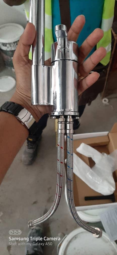

I bought a mixer tap and I want to convert the tap into cold tap only, so that the water will come out when I turn the handle on either direction.
Is it possible?
How to convert mixer tap ito cold tap only?
Is it possible? |

QUOTE(Created On 21/1/2021 @ Mar 31 2023, 08:34 AM) I bought a mixer tap and I want to convert the tap into cold tap only, so that the water will come out when I turn the handle on either direction. Yeap . I did this in one of the houses , Is it possible? So you have 1 incoming pipe (cold ) , then need buy valve that can split into 2 …. As per my picture below … so it’s now become cold water on both ways …. ![]() ![]() Hopefully your water pressure is sufficient enough …. Hope this help Cheers mate , izwan Www.archidstudio.com |
