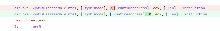

I was too rush when finishing the disasm.asm project, hence I confuse how to put a 32-bit unsigned integer into one of a pair of two 32-bit uint parameter. (Have to consider little-endianness in x86).
Below is the necessary changes (so that runtime address in disassembled instruction for conditional jump is correct):
This post has been edited by Tullamarine: May 23 2023, 06:44 PM

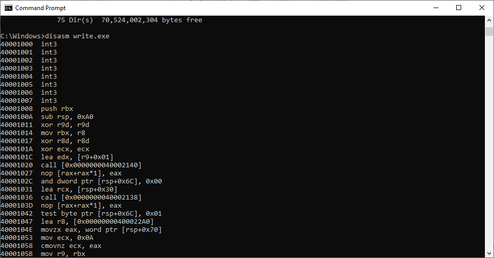

Below is screenshot of my disasm.exe, disassembling write.exe (WordPad) on the fly in command prompt window.
Notably "int3" is used in MSVC programs that shipped with Windows as padding byte for alignment. You will notice a sequence of "int3" through out these programs.
But my disasm.asm doesn't have code flow analysis, anything in code section will be disassembled regardless of data or code.
Yes, some programs may have data in code section, but these data (or data string) are not executed. So if data is interpreted as code and disassembled by my disasm.asm, then the output is wrong. sad.gif
In the case, always use high-end disassembler like IDA or Ghidra. biggrin.gif
junyian
post May 27 2023, 11:05 PM
401 posts
You should start disassembling from the entry point. Not the start of the .code section smile.gif

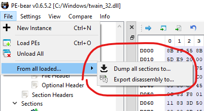

PE-bear is so powerful, that my EXEDUMP.EXE and DISASM.EXE are just two tiny functions of it.
https://github.com/exedumper/exed (A variant of EXEDUMP)
https://github.com/exedumper/disasm
(Both repos above were abandoned and no longer maintained, please don't submit PR)
