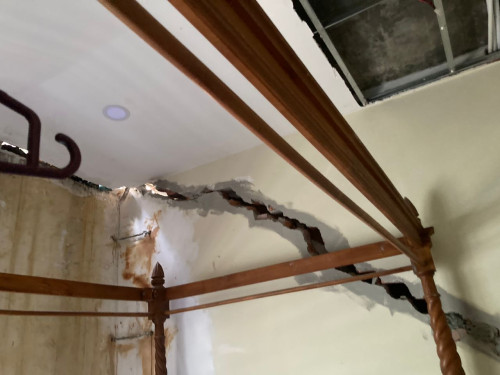

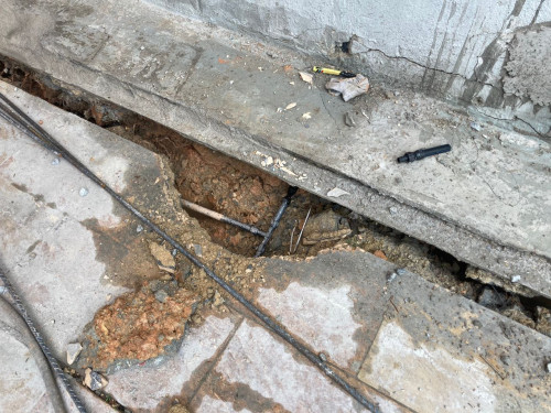

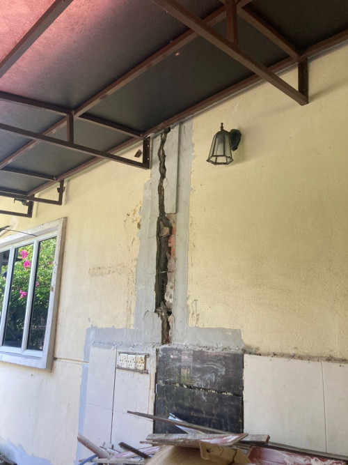

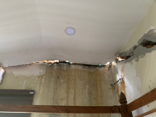

On my findings , this is the issues that the house is having:-
1) The new ground and first floor back extension is not properly structurally design. The first floor floor beam and the roof beam is tie to the original existing beam.
and same goes to the first floor R.C slab.....
A new extension should have created another new column after the existing building so that this old and new building have different structure loading purpose.
2) The ground beam missing... hahahaha..... crazy.....
3) Column design / R.C footing under design... so the double storey extension load cannot catered by the Footing and column thus settlement occurred .
The new beam and slab connecting to the existing building is producing "shear stress" that causes the building to have a major crack....
