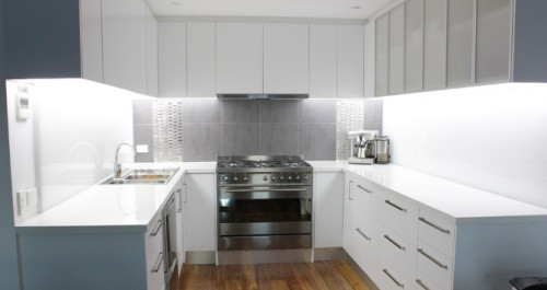

speaking from own experience. thats not enough.
you need lights from the cabinets too.
the work top is too dark due to shadow from cabinets.
like this example:
This post has been edited by ikeiyou: Mar 3 2023, 01:25 PM

just my sugestion, again, use 4 or maybe 6 smaller downlights instead.
those 3 large downlights will cause ugly shadows.
