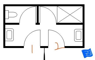

Bathroom is shared with room 1 and room 2.
Currently, inside the bathroom there’s a door knob that can lock. The push button type. Privacy lock. On the room side, there’s a deadbolt to lock it, and you can “unlock” the bathroom door using a screwdriver or a coin.
Problem:
1. person from bathroom 1 uses bathroom. Forgets to unlock door 2.
2. With a screwdriver or coin, can easily unlock the door when someone is showering inside.
Is there a better simple solution? Without fancy electronic locks.
Ideally, when person from room 1 enters to use bathroom, he locks door from room 2 which at the same time locks door 1. When he exits bathroom, he unlocks door 1 which also unlocks door 2.

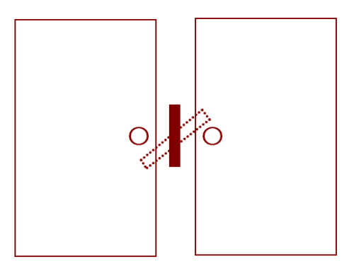

aliias

lowyat101
post Feb 27 2023, 02:33 PM
2,547 posts
Joined: Sep 2011
QUOTE(aliias @ Feb 27 2023, 02:31 PM)
haha good idea.
but what if the doors are opposite to each other instead? any suggestions? tongue.gif

aliias
post Feb 27 2023, 02:37 PM
16 posts
Joined: Oct 2010
shouldnt be a problem, as long as the doors open facing inside of bathroom. only worry for scratches on the doors.

TSJason
post Feb 27 2023, 05:46 PM
6,354 posts
I think from a practical standpoint, you win for the given diagram. thank you. if the distance between the 2 doors is long then that's a long bar.
now for those who have the doors to room 1 and room 2 on the opposing side facing each other, that's not solved lol.
