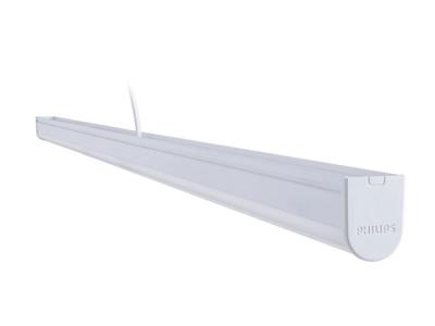

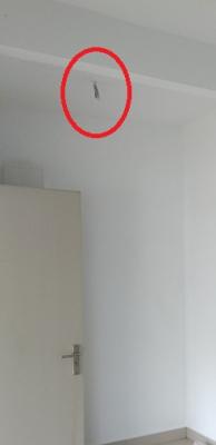

Ordered some Philips T8 batten but found out that the cable connection is on the top like the picture below.
I want to install it to the soffit of the slab with this type of typical cable outlet.
Thus I'm wondering, how to hide the cable connection as there's no space above the light batten to do this.
Any ideas or suggestions?
