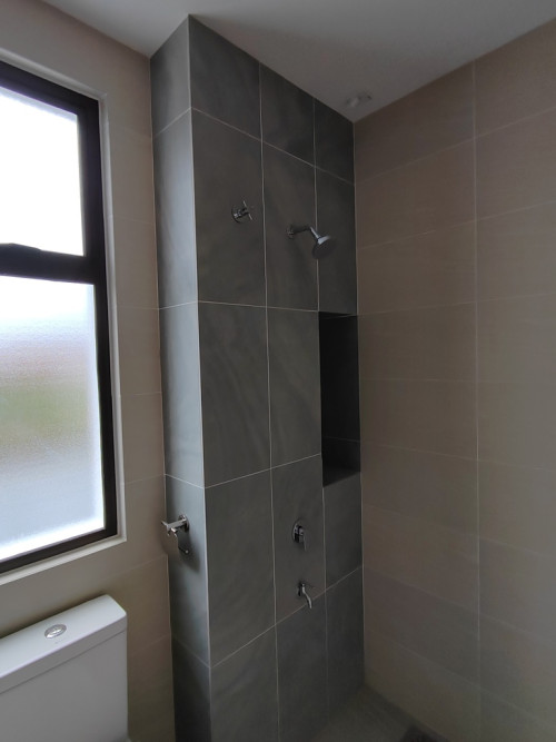

Hi,
Below picture is what developer provided.
Any shower set that has both rain shower and hand shower,
That is compatible with such setup?
(without any plumbing)
This set given not suitable for kids
Thanks

This is a concealed set, all plumbing in the box up. Should be able to use back current fixed piping to change to rainshower and handshower. Only thing is that not sure if bottom tap has hot/cold pipes for handshower. Sometimes developer cheap on this and only do cold water for the tap.

Park. TS any solutions so far? I got same prob only rain shower. The most I can think of is buy a shower head extender and attach diverter to hand shower.
But that’s like most low budget haha
