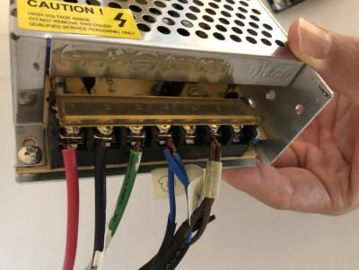

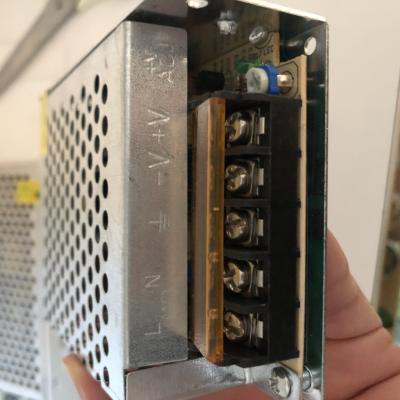

Hi guys, any of you who are more electrical pros can help me with this? Am trying to replace this LED driver and got a new one from Shopee. But the thing is the new one seems to be missing a few 'ports'? Namely the 'CO' ones (the 4th and 5th ports)? Am not sure which port on the new driver I should connect the blue and brown wires to? confused.gif

is it single color
V+ to V+
V- to COM

QUOTE(sykong01 @ Feb 5 2023, 12:48 PM)
is it single color
V+ to V+
V- to COM
Sorry, I don't quite understand what you mean?

Brown to V+
Blue to V-
On the new power supply

QUOTE(stormer.lyn @ Feb 6 2023, 01:12 AM)
Brown to V+
Blue to V-

acbc
post Feb 8 2023, 10:45 AM
9,045 posts
Read the symbols and follow back. Old and new ones same.
