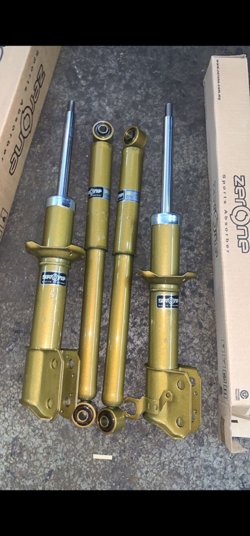

Can anyone recommend new absorber for kancil petak? prefer better handling and good comfort
thank you
jimmylim85
post Feb 6 2023, 09:30 AM
iPhone world....
7,832 posts
From: Ipoh
QUOTE(deskerz @ Feb 3 2023, 09:20 AM)
thank you
Stick to stock OEM absorber will do. Stock springs and 13” rims gives me the balance of handling and comfort. Ditch the lowered sport spring and go back to stock spring.

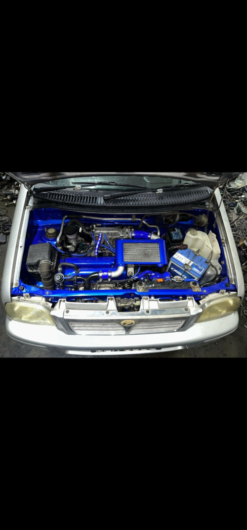

Finally My car is out from changing car engine to L5 JBJL turbo..
This is a very fun to drive engine! i did a few upgrades especially for old car ! such as add ground cable , changing some interior meter light bulb and suspension, change my radiator fan to high speed from half cut (made in japan).
Very satisfy with the car right now
will upload some photo later
I got some question need some sensei to give some advise!!!
My engine is now stock L5 JBJL!! do i need to change to hood with scope for cold air intake ?
My worry is water will go in! especially Malaysia heavy raining season!
