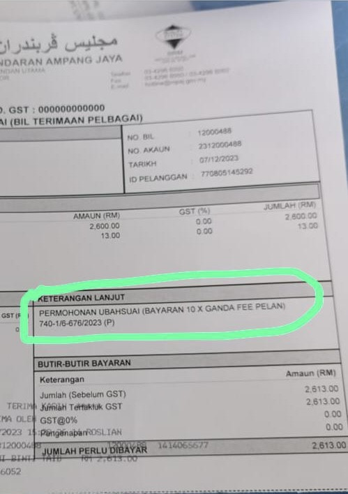

1) draw the whole house including the renovated area ..
2) the drawings highlighted in red (new area extension will be calculated )
Example : ground floor - rm 14 for every 9 msq and 1st floor rm 12 for every 9msq
Payment to MPaJ is something like this
Minimum - gfloor rm140 and minimum f.floor rm120 - plan processing fee
Penalty pemutihan - penalty imposed 10x amount of process fee plan
Total 140+120 : rm260 x 10times : rm 2600.00. ( this is last time I did ya for one of my clients ) plus few rm++ for MPaJ digital scan …
The rest are those forms and consultants to finish up and endorse..and the consultants fee
But make sure house is within the boundary line … if still the house is within boundary line still ok.. if exceed boundary then need to demolish or dismantle the exceeded area …. Boundary line ya not Buidling setback ….
Hope this help

Example

is this quote for mpaj pemutihan reasonable?
TSArchId
post Dec 23 2024, 01:26 PM
350 posts
Joined: Jan 2014
From: Kuala lumpur
QUOTE(ycs @ Dec 23 2024, 12:31 PM)
It is almost ended the pemutihan … December 2024 … but can ask MpaJ if there is an extension on this pemutihan or not … normally they would extend .. but better ask the officer first …
Price is reasonable..
question
1) Why need supervisor signature ? ( no need )
2) you have the original cf / ccc ? If no ccc cert ..the guy need to go for CF / ccc search at MPaJ
3) if no CCC , need to attach the MPaJ report along with the Surat akuan sumpah ( need to go see commissioner of oath ) ( does this price include ?
4) the price include printing ? He or she may need to print several times … I submit 2 of my clients .. last month … both like need to amend and revised several times based on the officer comments ..
5) Borang kebenaran jiran .. ( approval from neighbour of the extended area .. ) need them to sign and approve .. left , right and back neighbour
Hope this answer your clarifications
