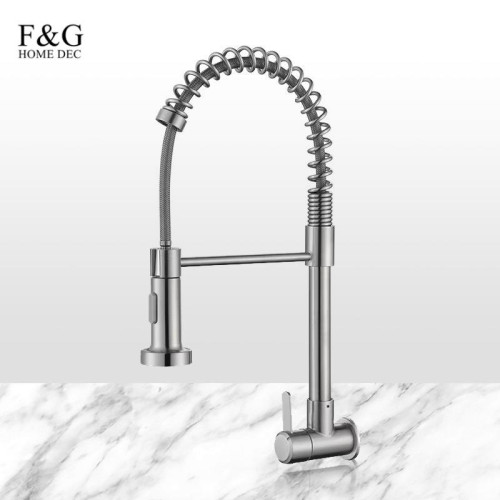

subdroid
post Jan 18 2023, 10:08 AM
139 posts
Joined: Jan 2011
liddis ah
TSlowyat101
post Jan 18 2023, 10:11 AM
2,547 posts
Joined: Sep 2011
QUOTE(subdroid @ Jan 18 2023, 10:08 AM)
liddis ah
ya showed this to my wife before, she said the spring section will be difficult to clean sweat.gif
anyway will arrange for a trip to the shop selling these types of taps for her to touch and feel tongue.gif
