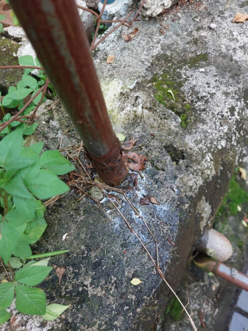

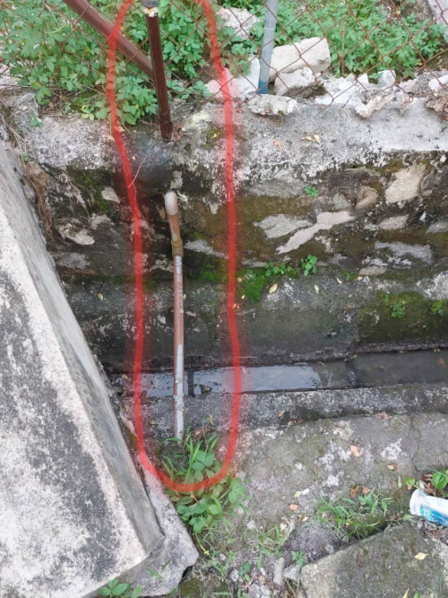

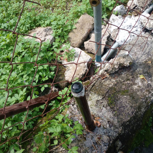

Hello. I'm seeking advice here. I bought a 30 yrs old house in selangor. The house has been vacant for 5 yrs. So i applied for new water meter installation from SYABAS. But team meter of SYABAS informed that they couldnt install the meter because there was no water in the piping before the meter from main & that i need to call a plumber to check & repair the piping & make sure water flows in the piping before the meter. The piping before the meter is rusty.
Is it the house owner responsibility to fix this problem? Because based on info i read in FB & blogs, faulty in piping before meter is under the scope or responsibility of SYABAS. Can i make a complaint & request SYABAS to fix the piping as it may involve digging the drain side wall and roadside for underground piping.
