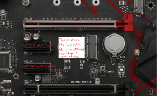

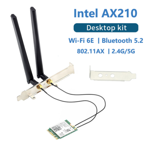

Was thinking of getting something like this
The mobo IO panel also have holes to mount the antennas as well.

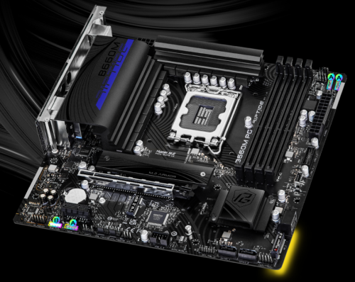

The card would go into this slot which is specifically for WIFI (example pic below)
This post has been edited by babylon52281: Jan 8 2023, 01:38 PM

QUOTE(babylon52281 @ Jan 8 2023, 12:26 PM)
I prefer this type of pcie adapter as it comes with heat sink and protects against interference.

QUOTE(asdasd @ Jan 9 2023, 12:26 PM)
[/spoiler]
might be blocked or partially blocked by the GPU though
[/spoiler]
I see. Unfortunately my mobo only has 1 open PCIE X1 slot other than the GPU X16 so I prefer if can avoid using up that slot unless necessary.
