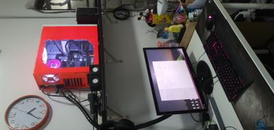

bobowyc
post Dec 31 2022, 07:14 PM
You are who you are.
1,921 posts
Joined: Apr 2013
From: Petaling Jaya
QUOTE(eddie2020 @ Dec 30 2022, 09:58 PM)
You mean sudden drop down? Haha
Oh I was considering that type of bracket as well..
I bought 10 inch x 18 inch.. Considering my table roughly 24 inch
So it cover 3/4 of my table depth. Perhaps I try mount it on and see if it's sturdy or not. What type of screw you use? And how heavy estimated your cpu?
Seems like overkill if I put 8 of 12mm hole on my wall.
Estimated weight of my CPU is around 10kg i suppose. haha. I use rawplug, those anchor type plugs, it actually came together with my brackets. Each bracket is a set of 2. So they gave 4 anchor plugs. Anchor plugs hold better compared to those wall plug and screws in the long run. Yeah, cover 3/4 of the table is good enough. Good thing my bracket was the exact same length as the shelve i bought, both 12inches.

bobowyc
post Jan 1 2023, 09:04 AM
1,921 posts
Joined: Apr 2013
From: Petaling Jaya
QUOTE(eddie2020 @ Jan 1 2023, 02:46 AM)
https://shopee.com.my/product/225619814/973...87-1672512343.9 izzit this type of plug? Haha I think it's quite sturdy as 10kg with 2 bracket and the shelf is not really long or deep
Yes, correct. This type of raw plug/sleeve anchor. Haha, okay then. xD haha. sweat.gif I mean as long as it holds la. lol
