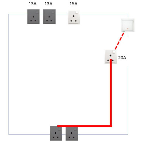

tumpang this thread to ask sifu, need your advise on the following
on the other side of my kitchen has no power point, I am thinking not to hack the wall, can i do extension cord from the existing 20A heater point thru plaster ceiling (i dont install heater) to the other side of the kitchen.. mainly will use for oven (~1600W), steam cooker (~1200w) and some small apliaces.. hardly will turn them all on at the same time la..
so sifu, can work or not? any thing i need to aware

post Feb 23 2023, 09:37 PM
1,132 posts
Joined: Apr 2014
From: Shah Alam, Selangor
Yes, doable exactly as you say. Nothing extra to be aware about if you follow all the wiring rules.

QUOTE(OrdernPay @ Feb 23 2023, 08:37 PM)
Water heater need its own dedicated circuit. You can repurpose a heater point to support 13A SSOs.
