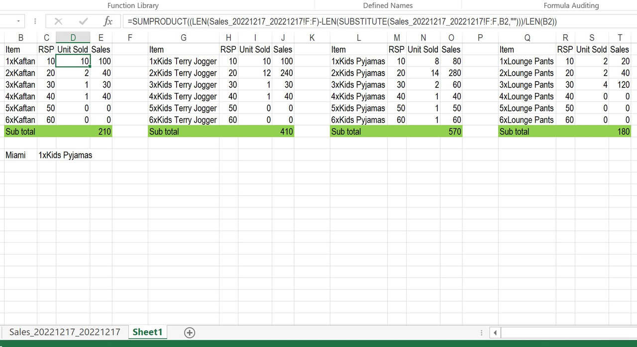

CODE =SUMPRODUCT((LEN(rawdata!F$1:F$30)-LEN(SUBSTITUTE(rawdata!F$1:F$30,B2,"")))/LEN(B2)) is there a way to put rawdata!F$1:F$30 range into one cell so i can change the formula to CODE =SUMPRODUCT((LEN(A1)-LEN(SUBSTITUTE(A1,B2,"")))/LEN(B2)) because i have multiple lines of this formula to process a batch of raw data editing each line is tedious so i was wondering if i could set the range into a cell then the formula always stays the same

QUOTE(cYus @ Dec 21 2022, 01:03 PM) » Click to show Spoiler - click again to hide... « try INDIRECT function CODE =SUMPRODUCT((LEN(INDIRECT("rawdata!F$1:F$30"))-LEN(SUBSTITUTE(INDIRECT("rawdata!F$1:F$30"),B2,"")))/LEN(B2)) or INDEX function to get values in a range and use in formula CODE =SUMPRODUCT((LEN(INDEX(rawdata!F:F,1,1):INDEX(rawdata!F:F,30,1))-LEN(SUBSTITUTE(INDEX(rawdata!F:F,1,1):INDEX(rawdata!F:F,30,1),B2,"")))/LEN(B2))  the raw data file will usually be on another tab every cell for unit sold will have that formula but it is a pain to change each of those cells when i plug in a new rawdata file

QUOTE(zenix @ Dec 21 2022, 01:37 PM)  the raw data file will usually be on another tab every cell for unit sold will have that formula but it is a pain to change each of those cells when i plug in a new rawdata file You may be looking at INDIRECT. It takes a cell reference in the form of a string and returns a reference to that cell, regardless of the sheet it is on. [CODE]=SUMPRODUCT((LEN(INDIRECT(A1))-LEN(SUBSTITUTE(INDIRECT(A1),B2,"")))/LEN(B2))[CODE] For example, if A1 contains the string "rawdata!F1:F30", the INDIRECT function will return a reference to the range "rawdata!F1:F30". You can then use this reference in your formula as if it was a normal cell range reference. This way, you can simply change the value in A1 to reference a different range in a different sheet, and the formula will automatically update to use the new range.

QUOTE(cYus @ Dec 21 2022, 01:50 PM) You may be looking at INDIRECT. It takes a cell reference in the form of a string and returns a reference to that cell, regardless of the sheet it is on. [CODE]=SUMPRODUCT((LEN(INDIRECT(A1))-LEN(SUBSTITUTE(INDIRECT(A1),B2,"")))/LEN(B2))[CODE] For example, if A1 contains the string "rawdata!F1:F30", the INDIRECT function will return a reference to the range "rawdata!F1:F30". You can then use this reference in your formula as if it was a normal cell range reference. This way, you can simply change the value in A1 to reference a different range in a different sheet, and the formula will automatically update to use the new range. sounds like a plan how do i setup indirect?
