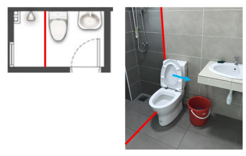

Hi, I am looking at this unit that come with a small bathroom, where the WC is positioned at the middle with little room to pay around with. I want to install the plastic panel/sliding door (at the red line) to separate the shower unit with the WC, to avoid water splashing over. However, it will be too close to the WC, isn't it? Is it possible to move the whole WC nearer to the sink (blue arrow)? Or any better suggestion? Thank you all

QUOTE(Human Nature @ Dec 15 2022, 08:01 PM)
Possible to move WC for landed unit, but not for high rise unit.

QUOTE(Human Nature @ Dec 15 2022, 08:55 PM)
Thanks for the insight. What would you do if you are in my shoes?
Use shower curtain instead of permanent screen. The railing can be made to any shape to fit the space and not necessary straight so that there is more room space.

QUOTE(Human Nature @ Dec 15 2022, 09:38 PM)
Did think of that, but not so fond of curtain as it makes the room looks abit cheap..
You have limited room space to play around. The reason why the wc is in the middle is because of the door.
You can check with the plumber whether this work ...
Adjust the wc to 45 degree facing the door. Then do a shower screen also at 45 degree. Relocate the shower head to the opposite wall.

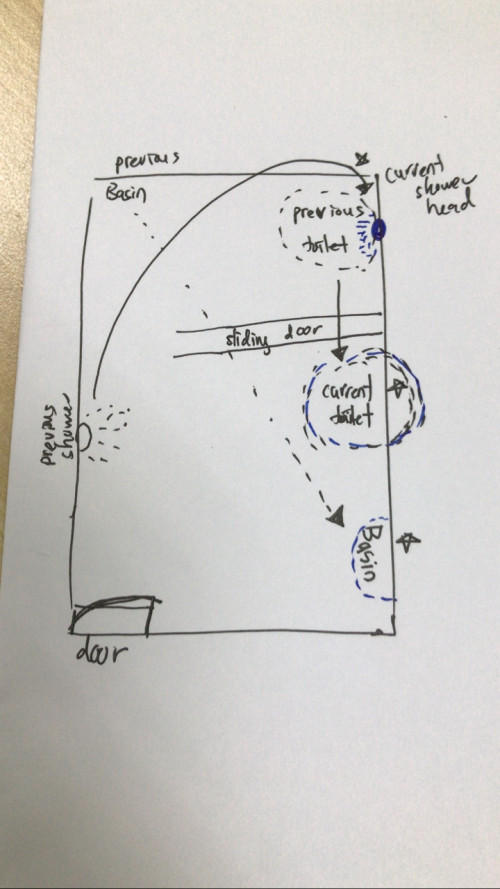

Tossing this idea around. What if tore down the whole wall (right side) and rebuild it one feet away. Then move the sink and WC to the right too. Too costly? Or sound stupid?

can offset a bit. using the offset flange
i think the most is 6 inch or maybe 8 cant recall
but still will kacau the bowl orientation.
coz if shift to the side-to-side cant move much compare shift front-back

QUOTE(Human Nature @ Dec 15 2022, 10:09 PM)
You didnt answer post #2, so we all assumed is highrise and the answer is no

QUOTE(Human Nature @ Dec 15 2022, 11:24 PM)
Oh, this is a landed unit.
If it’s on ground floor, can move. But costly. Hacking, water proof, tiling and when open the WC, wc may break if the installer use cement to fix the Wc. Small adjustment but costly.
Cheapest solution toilet curtain

QUOTE(Femsroot @ Dec 15 2022, 11:30 PM)
Is still worth the spending to have a bigger and functional bathroom toilet in the long run.

there is a concept of placing a wash basin outside the bathroom (depending on the room layout). then you'll get bigger space for the wc and shower.

Yes, you can move the toilet bowl. Just hack the floor, and extend the sewage pipes to where you want the w/c to be. Finally, make everything good again.
You'll be so much happier in the long run doing this now, even though the cost is a bit high

Another idea is not to hack the wall, but change the wash basin to a smaller one, then have more space to move the WC further towards the right side. Can save cost. And maybe change the swing door to a sliding/folding type.
