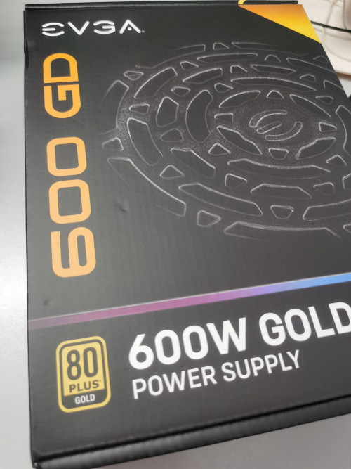

Dear Sifus,
I have recently bought a CORSAIR 4000D Airflow mid-tower casing. I am planning to migrate my old ALIENWARE X51 into this new case.
In order to do that, a new PSU is required. I am currently deciding between CORSAIR CV650 and EVGA 600GD.
Some of the prominent differences based on my research:
EVGA 600GD (~RM280)
600W
80+ GOLD
5 years warranty
Fan size 120mm
CORSAIR CV650 (~RM250)
650W
80+ BRONZE
3 years warranty
Fan size 140mm
Personally, I had used a couple of PSUs from CORSAIR but none from the EVGA.
So what are the thoughts on these 2 entry-level PSUs? Specifically on the build quality/after-sales service/RMA for each brand?
Open to recommendation for any PSUs below RM300
This post has been edited by GetUrAssKicked: Dec 14 2022, 07:57 PM

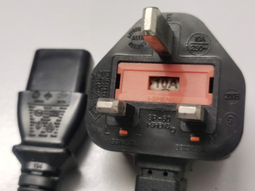

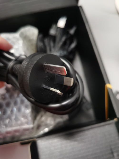

thanks for the input! Got my hands on the EVGA PSU last week.
Just realized it does not come with a UK plug.
Is this common across all EVGA PSU sold in Malaysia?

Joined: Feb 2007
QUOTE(GetUrAssKicked @ Dec 26 2022, 09:35 AM)
you can buy the c13/14 power cord, just get the one with fused on the plug one,
https://en.wikipedia.org/wiki/IEC_60320#Appliance_couplers

This common. And for RMA need to send to USA. But very reliable, mine comes with 10 years warranty.
TSGetUrAssKicked
post Dec 26 2022, 02:36 PM
73 posts
Joined: Jul 2013
From: Krypton
QUOTE(1024kbps @ Dec 26 2022, 09:55 AM)
Thanks for the suggestion. I plan to reuse the power cord previously came together with my ALIENWARE X51.
TSGetUrAssKicked
post Dec 26 2022, 02:45 PM

Oh really. Thanks for confirming.
Since both EVGA & CORSAIR are both American companies, it's weird to see EVGA PSU came without an UK plug while a couple of CORSAIR PSU that I had previously owned/still owned all packed with an UK plug out of the box.

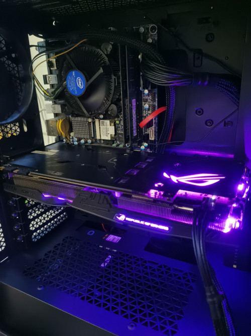

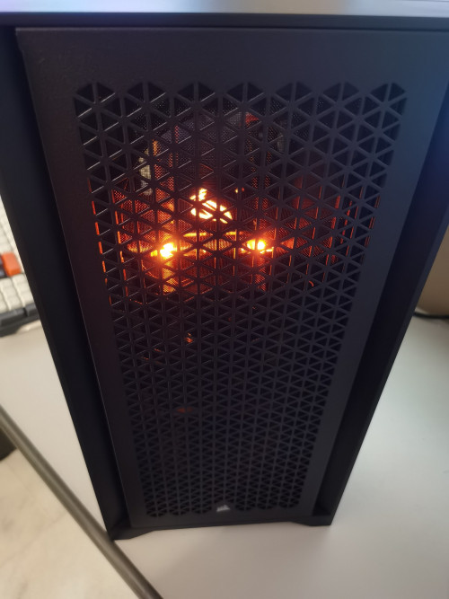

Just completed the migration without any obstacle.
Everything is up and working.
Thanks again to all the sifus for chipping in your precious inputs. Really appreciate it.

IINM PSU brands will put in the relevant plug type to the country/region of sales, so likely those brought in officially would come with UK plug. Some parallel importers that got their stocks from SG or UK would do too but online sellers likely got from elsewhere, your probably got their stocks from China or Australia retailer.
